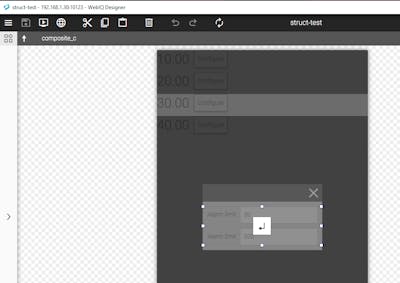

I've created a composite with a dialog inside the widget, but the configured placeholder is not carried over.
In the designer it works, here you see i'm inside the third composite:

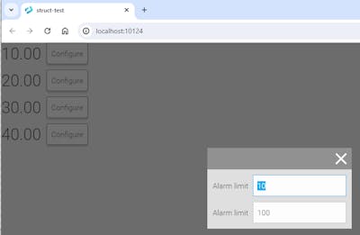

But when klicking the third button in chrome i get the value of the first composite:

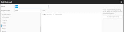

I have a snippet that looks like this:

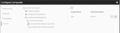

A customer of ours found this and I managed to reproduce it in a small test project that are attatched below.
Designer version 2.15.0 with Server version 2.15.3 (Behaves the same in 2.14 though)
Best reply by webiq-sk
Please see the Composite Demo for a working example: https://demo.smart-hmi.com/demo-composites/
You can download it right from inside WebIQ Designer (>=2.15) - when it comes to dialogs all composite instances are created equal - all of them reference the first dialog from the first composite - the Composite demo shows a working instance.
