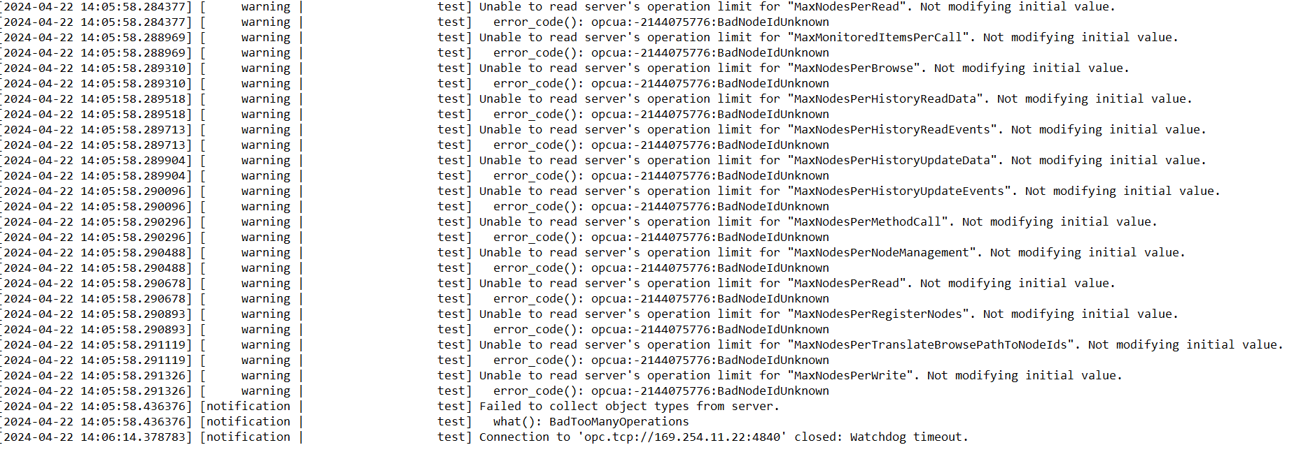

I have the same problems. I'm trying to connect a Symotion via OPC UA and I can't open the node tree, it disconnects. Looking at the logs, there are problems with the maximum number of nodes, but with UA Expert I can read them.
Did you find a solution?
