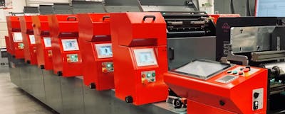

For a Motion controller application, we will have 10 HMIs connected to an MLC Controller (up to 12 following the configurations).
the HMIs will be WR21 (7" and 15"), the maximum amount for tags are around 1000 tags (~100 per HMI),
my questions are :
- is it possibe to configure and licence 15 webClients into 1 WebIQ Server.
- is yes, a ctrlx Core (used only as WebIQ Server) is enough to manage them ? or do we have to consider an IPC Based server ?
