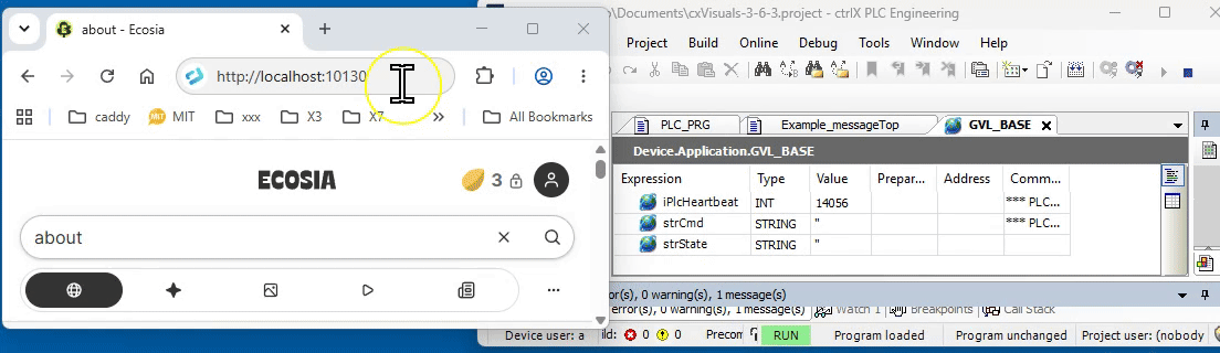

  • The connection is established when the WebIQ project starts
  • The heartbeat variable is incremented by the PLC,
  • In the video you can see the variable changing
  • Action (OK) virtual:bPlcConnected = 1 (TRUE)
  • Action (Failure) virtual:bPlcConnected = 0 (FALSE)
    • The graphic "connected" is displayed correctly,
    • but virtual:bPlcConnected is FALSE
