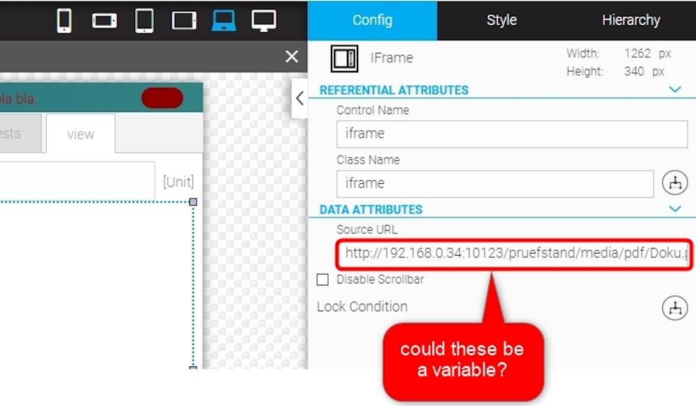

I'm using the IFrame to display PDF files. Is it possible to work with variables/placeholders to change the Source URL, see picture below?

See similar thread here:Â /smart-hmi-webiq-designer-and-server-zqilynus/post/inserting-variable-into-webiq-ui-actions-KaZeyKrxHORCIve
Also, I've attached a custom widget that allows the iframe source to be a variable/item. (This is sample code and has not been tested exhaustively. Please contact me if you see any issues.)Â
The WebIQ documentation describes how to install and use a custom widget.
