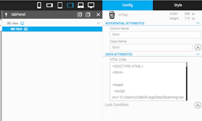

I am trying to use this simple example with the WebIQ HTML widget. The code works correctly but if I paste it into the "HTML code" section of the widget then the Java part of the json file no longer works.
You can find the file in the zip folder, I simply copied the html code into "Html Code".
Can you tell me what's wrong? I've tried pointing to the json file and creating the same one with the "code manager" tool and then pointing to that but nothing. I've also tried putting the files in the appropriate folders inside WebIQ for css and local scripts. Both the image and the css settings work, it's only the animation via java script that never works.
