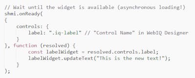

1. this is the suggested solution:
2. Information on the web framework can be found in "WebIQ Visuals Reference" documentation - however in this case only digging into the source code for this widget will lead to a solution (visuals-controls.js). The "WebIQ Connect 2.10 API" documentation is for the server, not for the web framework.
