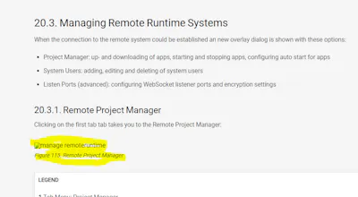

I think you did everything right. But to access the HMI app on the ctrlX Core, it must be started. "Autostart" should also be set so that the HMI app is automatically reactivated the next time it is restarted.
You can activate these functions in the Remote Runtime Manager Manager:
You can then access it directly via the url http: // <your-ip>: <10123> / <your-app-folder>. E.g. http://192.168.1.1:10123/myApp.
It's a good idea to do a video tutorial here, we'll tackle that.
Further information can be found in the manual: https://www.smart-hmi.de/user/download/deliver/docs/documentation-manual-webiq-designer-2.9-a788/index.html#_managing_remote_runtime_systems
Hope this helps and I wish you every success.
