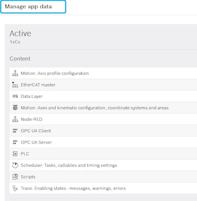

What about the manage app data mechanism of the ctrlX CORE? Will the WebIQ-App participate to this mechanism in the future for an easy update/backup/restore t.e.?

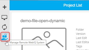

When the ctrlX is in the same network, you can use the "Remote Manager" of WebIQ designer.
  • Start Designer
  • Select Project List>Remote Manger
  • Enter IP address of ctrlX and port (Default port: 10123)
  • Enter login data (user: admin password: the password of the WebIQ app on ctrlX)
    • If login fails, check login data and firewall settings
  • Transfere or upload WebIQ project
