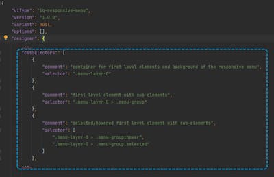

Best reply by webiq-sk
It should work when you add the corresponding meta data to your meta data file of your custom widget - here is a screenshot of the code from the iq-responsive-menu that shows the name and structure:
