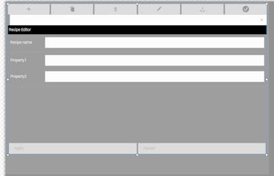

I have a project where I need to put a Recipe Editor in a popup window. The problem is that the Recipe Editor changes the color of the fonts to white when it is put in the popup window. I want to ask if there is a way to change the color manually or if there is some other way to solve this problem?
I recreated the problem in a new project and attached a screenshot of the popup window with a grey background color as well as the project itself. To open the popup window just press the button labeled "popup".

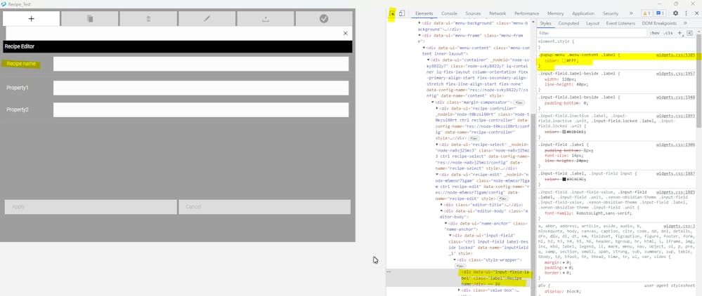

When working with any website, familiarizing yourself with how CSS debugging works in a browser is highly recommended.
If you press F12 in the preview or in a browser with the HMI loaded and select the label you'll see why this happens:

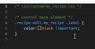

It happens, because all labels inside a popup are by default shown in white, so you can override this CSS by creating a custom CSS by selecting the "Recipe Edit" widget in Code Manager:
If you name this CSS "my_recipe" you can use the exact same code as shown above.

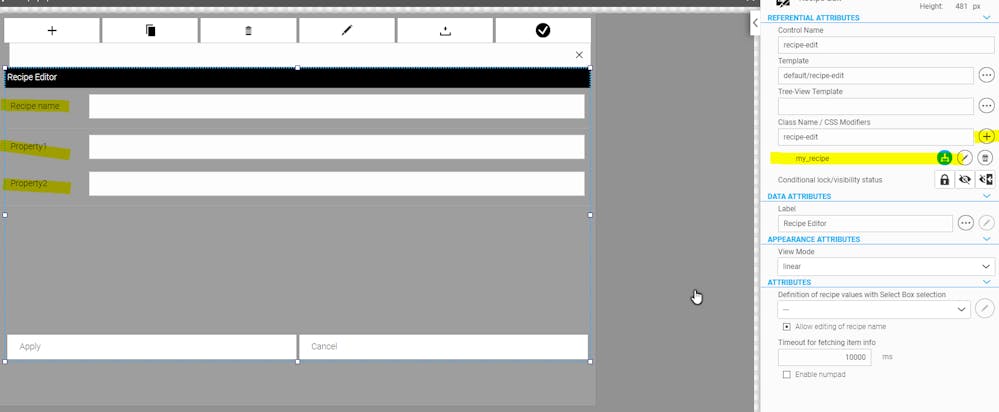

The in the popup select the Recipe Edit widget and simply add the CSS modifier "my_recipe" there:
