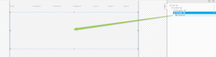

I've implemented local script which generate table of widgets according to their index.

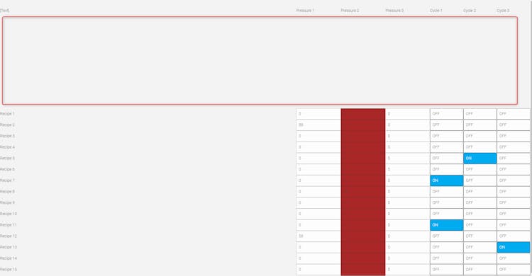

Now this code insert table dynamicaly after my holder element: list-target container. How to change code to insert table directly to the list-target container?
