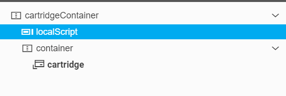

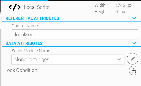

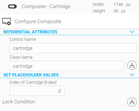

The last log I can see is "module ran" which shows it's never running onReady. I've attached images of how I have my layout.

As a workaround you can rename your cartridgeContainer in such a way that it does not contain the word "catridge" like in the other widget.
It will work if you rename it to e.g. "c_rtidgeContainer" - there is an issue with same names here.
