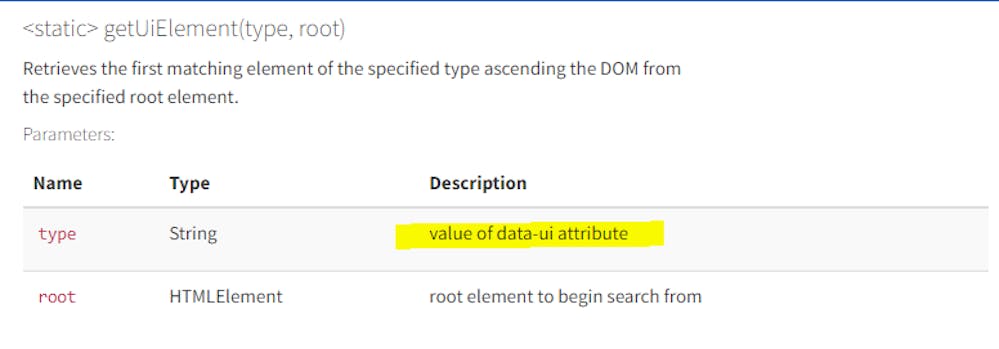

For using shmi.getUiElement(elementName) you always have to specify the data-ui-attribute name you specified (hence it's called getUiElement). This is also specified in the documentation:
https://www.smart-hmi.com/user/download/deliver/docs/documentation-webiq-visuals-reference-2.14-3d30/shmi.html#.getUiElement__anchor
