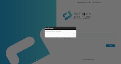

Hello community,
I currently facing problem in WebIQ log in window which it showing "Connection to server interrupted"
Other than that, I also saw that the WebIQ Runtime app in WebIQ cannot be start also.
I had verified that the problem was happened on the ctrlX CORE side due to my laptop can access into WebIQ designer when using another ctrlX CORE.
Information:
1. ctrlX CORE version: 1.20
2. WebIQ version: 2.14
3. using trial license
Hope someone meet this problem before and could resolve this issue
Best reply by webiq-sk
It looks like the WebIQ connect.json configuration file has been damaged in your installation:
This usually could only happen on unexpected power loss during setup, however we haven't seen this issue before.
Can you please uninstall and reinstall WebIQ and try again?
