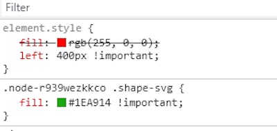

Thank you, it cannot work the way you did, because you used instance styling which always overrides any custom styling:
It always must override any other styling because it cannot "know" what the user wants (there can only be one winner). If you remove this, then it works as intended.
I also recommend to familiarize yourself with the browser's developer tools as this makes it easy to find out why it doesn't work:
There is no difference here between writing JavaScript in WebIQ or any other website - it's exactly the same here - this explains CSS specificity: https://developer.mozilla.org/en-US/docs/Web/CSS/Specificity
The information on the instance styling was omitted from the original description so I couldn't provide a sufficient explanation - in the future please always provide all information available - that will make it a lot easier.
You can however override this without removing the instance styling in WebIQ Designer, but this can only be done by setProperty:
//svg.style.fill = '#ff0000';
svg.style.setProperty('fill', '#ff0000', 'important');
Then this will work, because of the "important" added.
