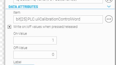

It seems that the read/write feature when using bit access for variables does not work. Here is the configuraiton I am using:

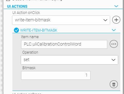

When I do something similiar with a UI action it works but this is not a reasonable solution in my application.

It's always helpful to open the browser console in the HMI (F12, like in any browser) - this will likely show an error like this which I just encountered while trying to reproduce the issue:
This has now been planned to be fixed with WebIQ 2.13 which is scheduled to be released within the next few weeks.
