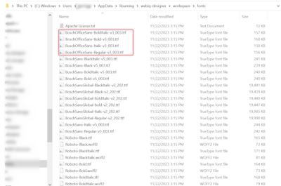

I have uploaded all ttf files into the following font folder:

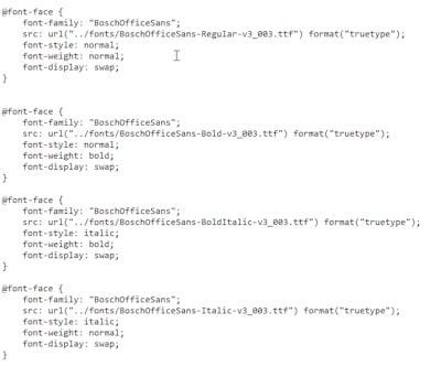

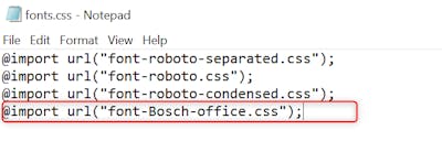

And have also added a new CSS file and added the importing line to fonts.css
with following codes:

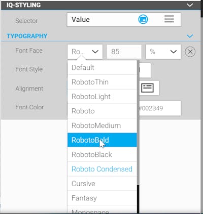

I have then, also restarted WebIQ Developer but yet the option for bosch-office font is still not available in the developer.

The thing you did on your CSS code is defining the fonts, just not using it. This is not a WebIQ question, but a general CSS question.
Just set the fonts the way you want to use them (I don't know, so I can't give specific advice).
Setting all fonts on the page not overridden by IQ styling to BoschOfficeSans:
