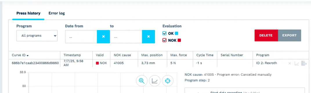

NOK Cause in the History
If a curve is evaluated as NOK, the NOK cause and the related step are now shown in the history, making troubleshooting and correction easier.

Display of Program Step Duration in the History
In the sequence view of the history, the duration of each step is now displayed. This information enables targeted measures to reduce cycle time.
