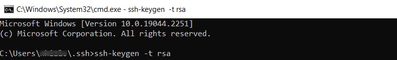

3. Type this comand int the console to generate a private/public key pair: ssh-keygen -t rsa (please don't enter a passphrase)

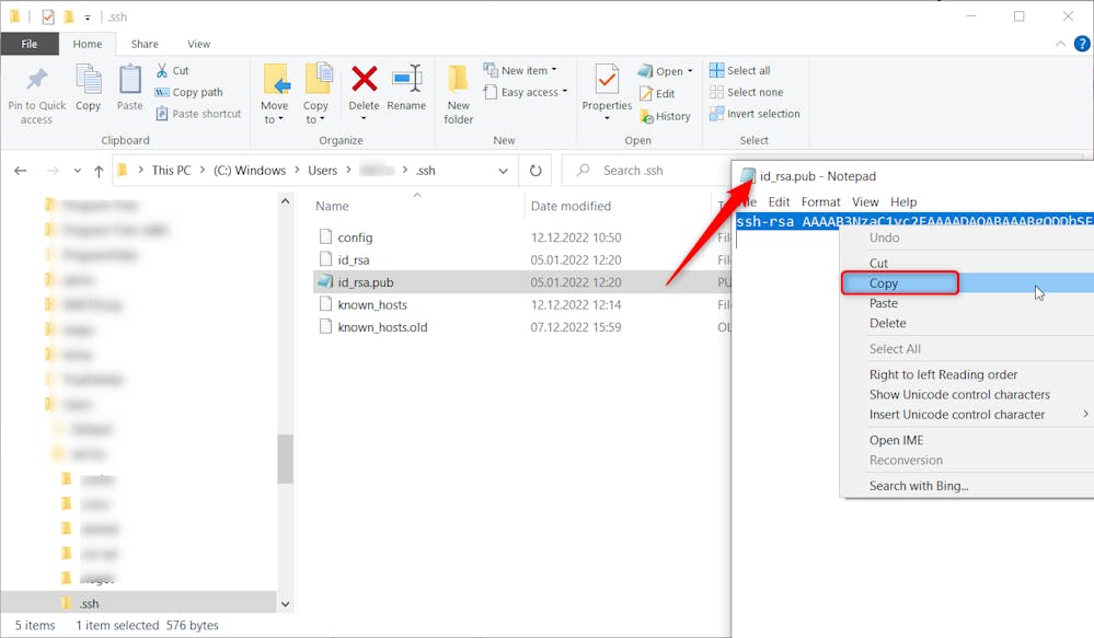

4. You will see that your key pair got generated. Open the public key (id_rsa.pub) with a editor and copy the value out.  

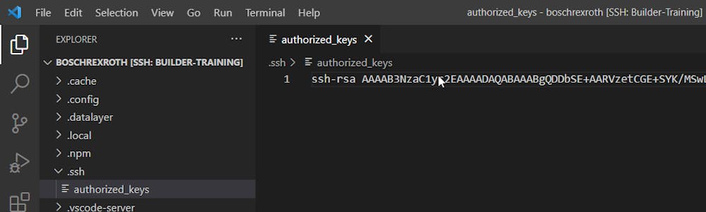

5. Connect with Visual Studio Code to your App Build Environment. Open the home folder (File -> Open folder: /home/boschrexroth).
6. Create a folder ".ssh" here and create a file inside this folder with the name "authorized_keys". Paste in the public key you just copied and save it.
This should do it. Please see also this section in our documentation: SSH Connection/Public Key Authentication.
