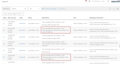

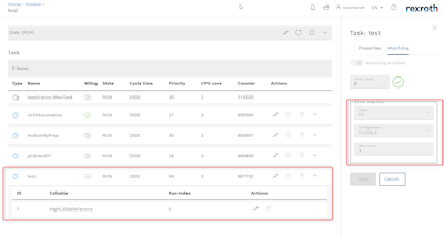

I use 2ms scheduler to scan my program in virtual core. I have recorded the program scan cost time in scheduler, somestimes when the code is too many, it will cost more than 2 ms to complete the whole program code scan. But I didn't see any watch dog error or information about scheduler cycle exceeded. Is there something wrong setting with my virtual core?Below is my scheduler task setting and my recorded cost time in program:

The ctrlX COREvirutal is not real time capable. The times you are measuring are not really meaningful. If you want to measure cycle times you would have to do that on a real ctrlX CORE. Also the scheduler on the ctrlX COREvirtual runs in debug mode, because of that. And also the Hardware Watchdog is disabled.
