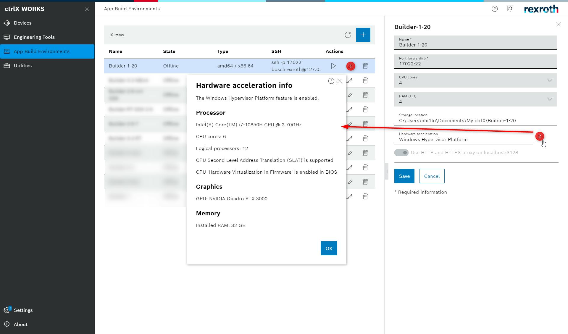

When the performance of the App Build Environment is slow, I would recommend to take a look at the hardware acceleration settings on your PC.
Like this you can check in ctrlX WORKS if the Hardware Acceleration is active:
There is now known issue with Windows 11. I personally also use Windows 11 and it works fine.
But I had once a problem with Windows Hypervisor Platform and what helped me was to deactivate the Windows Hypervisor Platform in the Windows Features, restart my PC, activate it again and restart again.
