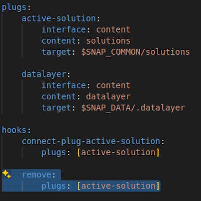

Hello Sgilk,
Thanks for your detailed insights and explanations!  I noticed that I already had the solutions content interface, but the remove hook was missing the plug towards the active-solution. My remove hook now has all the neccesary permissions to remove my app directory. I simply added the higlighted code below:
Have a nice day!
