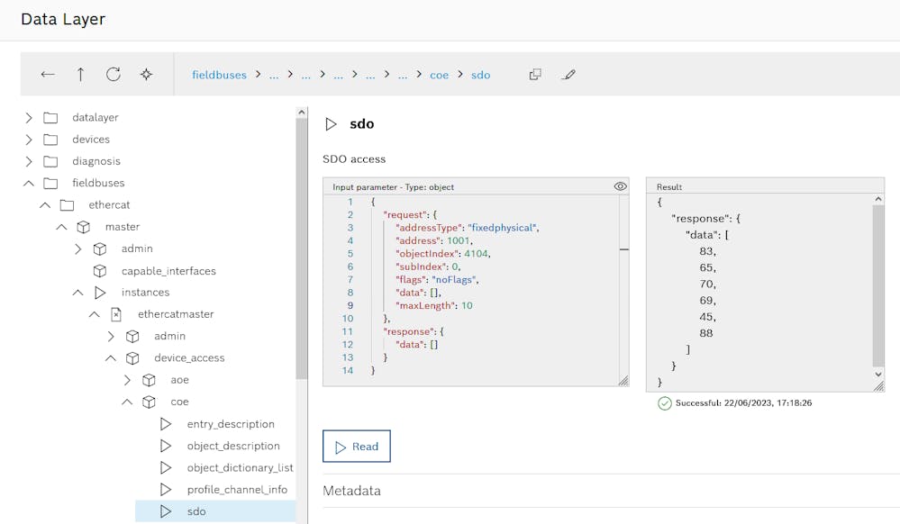

I'm trying to read a CoE object from SAFEX-C.15 via Golang application. When using the Datalayer UI directly I can read successfuly:

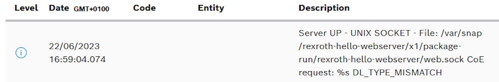

    fmt.Println("CoE request: %s", res)
    if res != datalayer.ResultOk {
        w = "Error!"
        return
    w = fmt.Sprintf("CoE request OK: %s", res)
    return
The node is "fieldbuses/ethercat/master/instances/ethercatmaster/device_access/coe/sdo"
After the ReadSyncArgs function call the result reports DL_TYPE_MISMATCH.
Can you please help in understanding what is the problem? I believe the flatbuffer implementation is correct and there is no reason for the type mismatch error.
