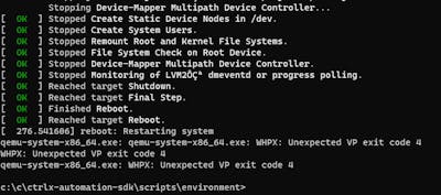

I used the create-new-vm-amd64-noproxy.bat to create the VM and launch-amd64-noproxy.bat to run it.
But opon completion it showed this message:

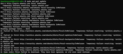

So I tried to use apt-get update to update some other packages and it didn't work:

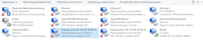

After further investigation and comparing to my collegues Windows 10 machine, we found out that the .bat script seems to fail on creating the necessary network adapters. The following is a screenshot from my collegues network adapters:
And here are mine:
The adapters starting with DE-AD-BE-... are completly missing.
Did someone encounter the same problem? Or does anyone know how to solve this? I'm fairly sure that it has something to do with Windows 11.
