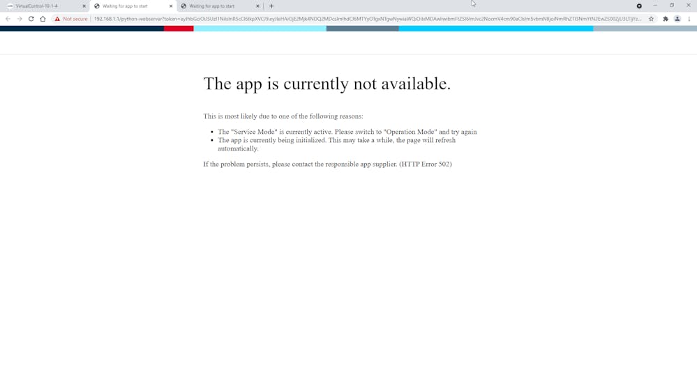

I tried the python.webserver example from the SDK 1.10 and I was able to snap the example but unfortunately once when I want to open the web page of the webserver on a ctrlX CORE virtual I just get the following screen:

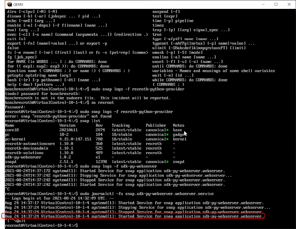

The ctrlX CORE virtual is in Operation Mode. When I am trying the hint of the readme.md to take a look into the log of the snap it says, that the webserver is started:
Unfortunately I get no other diagnostics even not in the logbook...
