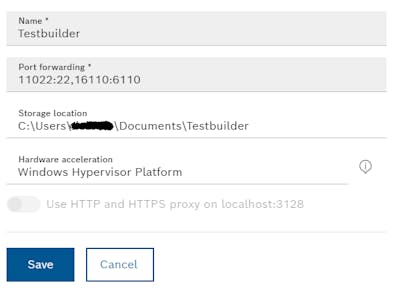

I'm developing an App with UDP communication. But I had trouble getting the communication running, even though I've entered the port number in the "Port forwarding" field.
Then, I've found out that CtrlX WORKS is assuming tcp, which leads to the following line in the "start.bat" file of the app build environment:
call launch.bat amd64 noproxy "hostfwd=tcp::11022-:22,hostfwd=tcp::16110-:6110" Testbuilder whpx:tcg
When I manually changed it to "udp" and started the environment manually via "start.bat", my communication worked.
call launch.bat amd64 noproxy "hostfwd=tcp::11022-:22,hostfwd=udp::16110-:6110" Testbuilder whpx:tcg
Unfortunately, on every start via CtrlX Works, this line is set back to "tcp".
Is there a way to define port forwarding for "upd" in the app build environment properties in CtrlX WORKS?
