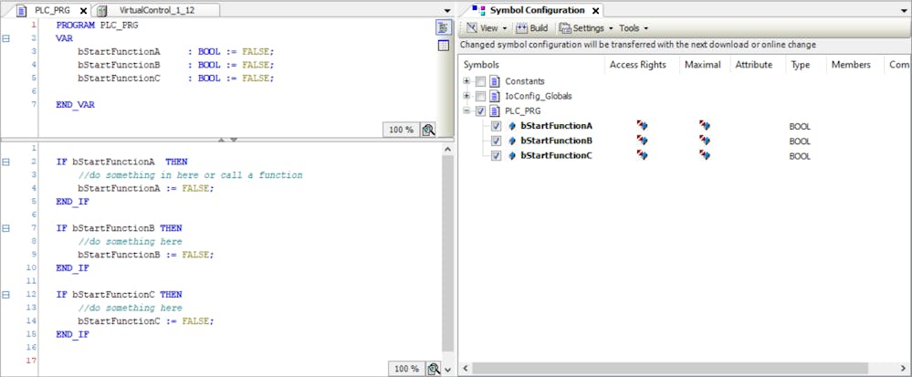

I think the best workaround for you would be to have a bool variable in your PLC project and publish them to the Data Layer. From the Python App you can set the bool to true, when you want to start your PLC function. In the PLC program you can start your function when the specific bool variable is true and set the variable back to false, if you have finished the function (see screenshot and link in further information).
