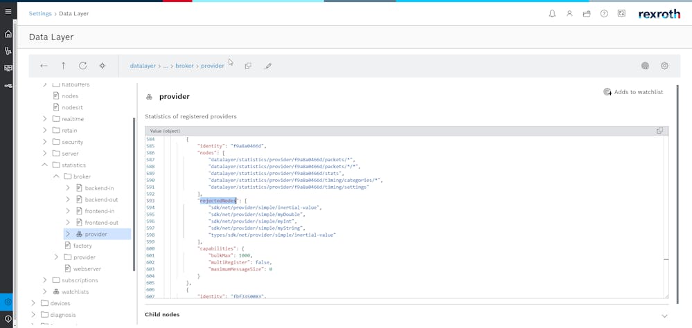

You can confirm that the nodes got rejected, if you look in the Data Layer at "datalayer/statistics/broker/provider". Here you can see the "rejectedNodes" for your provider.
