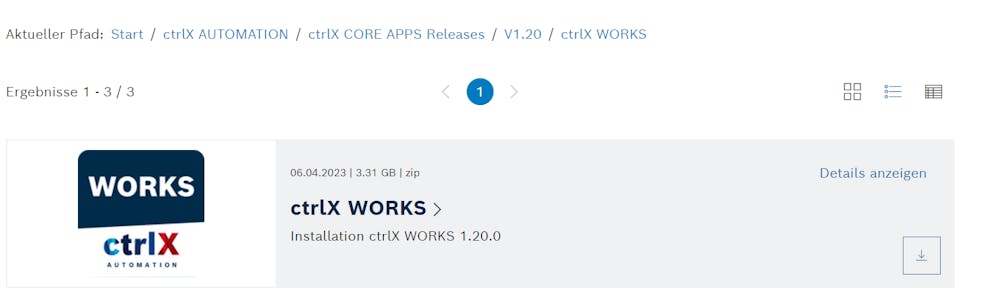

The Early Adopter Release (like the V1.20 currently, till end of July) you will get from a different folder in the Collaboration Room. See my screenshot:
ctrlX WORKS in the Collaboration Room at the path: ctrlX AUTOMATION/ctrlX CORE APPS Releases/V1.20/ctrlX WORKS
If you are not able to see this location please have a look at the FAQ for ctrlX Store and request access to "access level 3".
