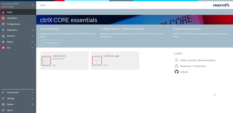

Is it possible to use own icons for the side bar and the app favourite list of the landing page for an user app instead of the given icons of the SDK resp. of the BoschIO web design box (red marked in the picture)? And if yes, how?
The icons in the sidebar and the overview have at the moment to be chosen from the Web Core icons pool see attached. Please use the corresponding names in the manifest.json.
Only the picture visible in the installation area can be taken out of the snap it self.
