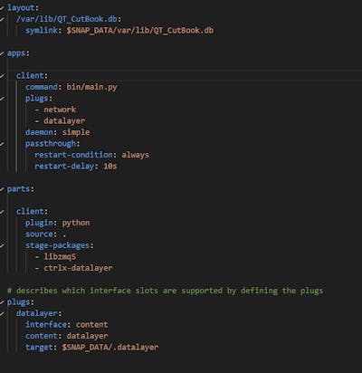

Hey guys, I am writing an app that looks up information in a sqlite database and forwards it via datalayer to the PLC application running on the core. However I am unsure on how to include the database in the snap. I've tried using the layout feature in the snap.yaml to create a symlink to the database but I am not sure if this is the correctr approach

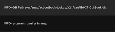

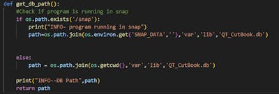

I am also currently dynamically setting the path in the main program but when I print the path to the log I don't see the snap_data directory being used any thoughts are appreciated.
