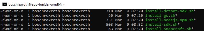

As an App Build Environment you nee a Ubuntu 20.04 Linux operating system with a special set of software packages and certain settings. There are several alternatives for such an environment. I would recommend to use the App Build Environment which is integrated in ctrlX WORKS (since V 1.14). See this documentation on how to setup this development environment. After the fist boot you can run some install scripts which are part of the virtual environment to download an unzip the SDK or to download some additional packages for a specific programming language (see screenshot). After that you can connect from Visual Studio Code (locally installed on window host) to your to your App Build Environment with ssh and the use of the "Remot SSH" extension and the connection string (eg: ssh -p 10022 [email protected]).
