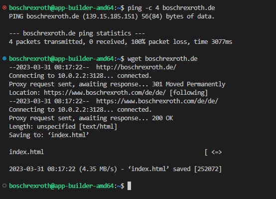

its a little bit difficult for me to reproduce your issue.
Be aware that ping does not work by default in the App Build Environment. I use wget for example to test my internet connection. In this screenshot you can see, that ping fails but wget works. This shows you, that the Internet connection does work, even though the ping fails.
ping fails but wget works in app build environment
