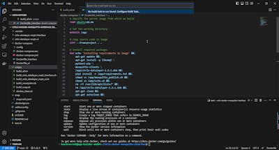

I am trying to follow the video example, but i had trouble snapping the app.
I am using ctrlX works App Build Environments and vscode to established a SSH connection.
I run below command:
1) Git clone https://github.com/S-Gilk/ctrlx-docker-mosquitto-interface
2) sudo apt install docker
Now i will need to configure buildx
How to configure buildx?
When i tried to run build task, it is not recognised in the build task terminal.
