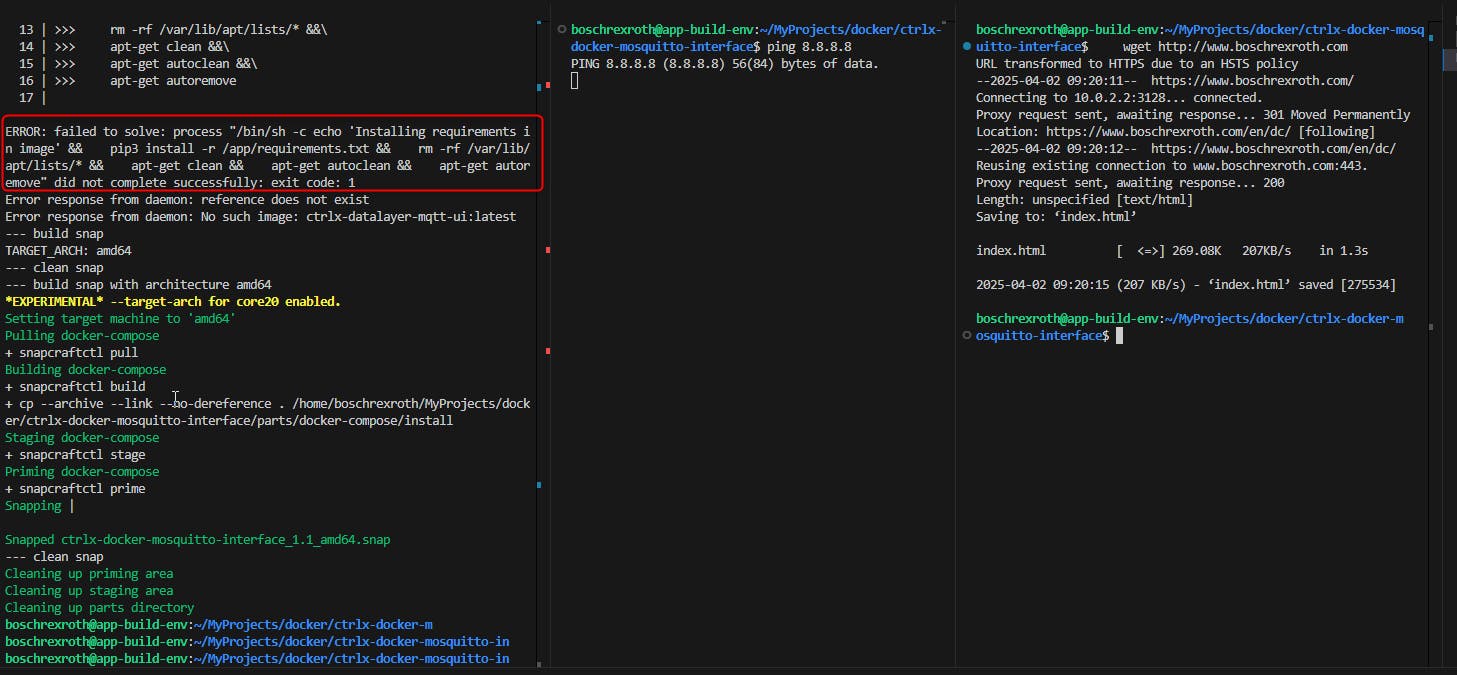

I'm following the tutorial Deploy Docker Image to Container Engine App. I followed the README and ran the script "build_all.sh". My snap image is created successfully, but I encounter an error during the build process:

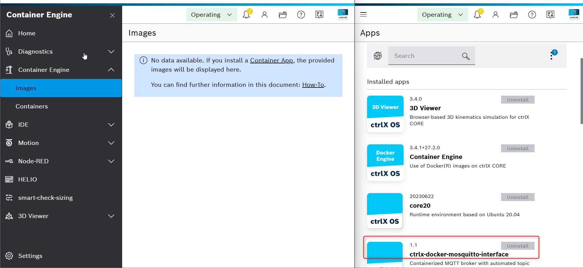

If I download the snap app on a virtual CtrlX3.4, I don't see any images or containers :
I suspect my snap isn't built correctly due to missing Python requirements. In your video, Sgilk , your development environment is called "DevEnvNoProxy." I tried using my 4G connection with the Bosch VPN, but I still face the same issue. Could you please share the internet method you used?
