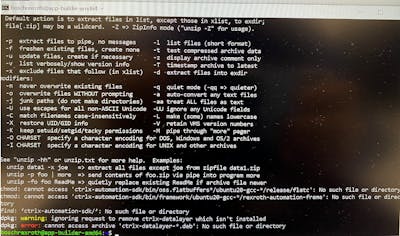

'ctrlx-datalayer-*.deb': No such file or directory
I have created a fresh instance for the App build environment, and I was following the setup video below step by step, but after executing the './install-sdk.sh' command, I get the below error at the end, it seems that the ctrlx-automation-sdk folder is missing?
I also could not connect to host through the Remote -SSH on Visual Studio, not sure if these two issues are related.
Any ideas would be appreciated, and sorry if these were obvious, I am still starting to play with the SDK and the App build environment.

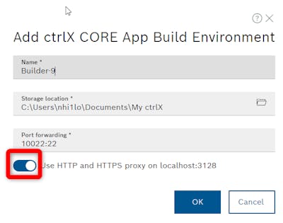

it looks like your App Build Environment does not have a network connection, or your App Build Environment didn't have the connection during the first boot. During the first boot many important package get installed.
I would recommend to create a new App Build Environment and make sure that the virtual environment got a network connection. Also be sure to wait until the App Build Environment shuts down itself.
When you create the App Build Environment have a look at this box:
  • Select 'Use HTTP and HTTPS proxy on localhost:3128' if your host is behind a proxy. In this case install and run px.exe before you start the App Build Environment.
  • If your host is not behind a proxy you have to uncheck it.
