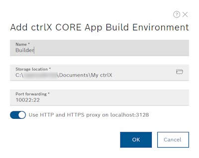

  2. Create a new App Build Environment in ctrlX WORKS with the plus symbol. And please check the box for the proxy connection, which uses the default port 3128 of Px. See also this documentation.

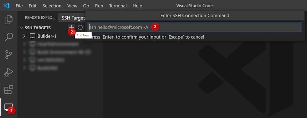

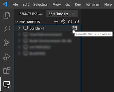

  2. Install the extension "Remote - SSH" in Visual Studio Code. Now it is possible to create a ssh connection form Visual Studio Code to the App Build Environment. Click on the Remote Explorer in the Sidebar -> Add new [+] -> type in the SSH connection "ssh -p 1022 bos.....". Select where you want to save this and your host is added. Now you can connect to your App Build Environment.
