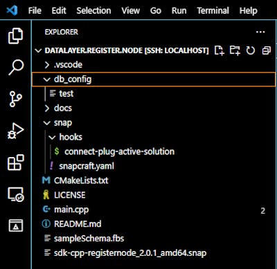

  1. Add a folder "db_config" including a test file and a folder "hooks" including the hook executable "connect-plug-active-solution" to the project:
    1. Make file "connect-plug-active-solution" executable
      chmod +x connect-plug-active-solution​
  2. Add changes to "snacraft.yaml"

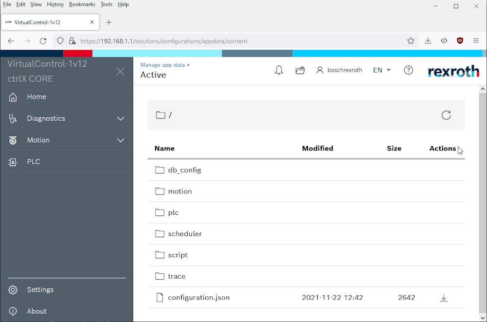

After installation the folder "db_config" is added to the active configuration including file "test"
