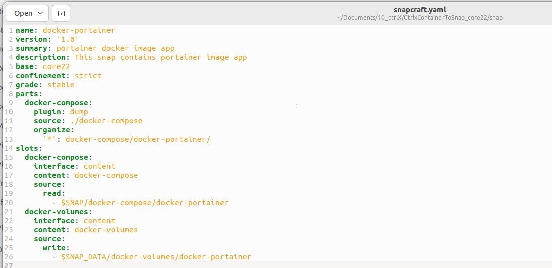

In the snapcraft.yaml I have the following configuration base on core22

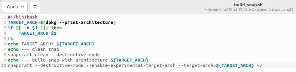

Inside my build snap script, I have the following :

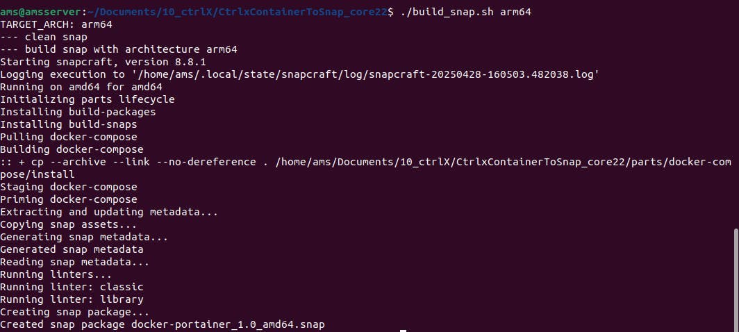

When I run the script : ./build_snap.sh arm64
It always at the end create a file : docker-portainer_1.0_amd64.snap and I can not install it in my ctrlX3 because it is a amd64 format insted of arm64...

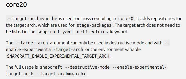

Additional informations : if I change snapcraft.yaml file to core20, I can now build the snap correctly in arm64 or amd64 format...

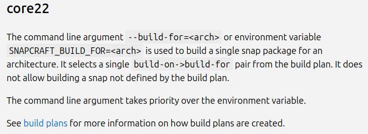

I checked snapcraft documentation : https://snapcraft.io/docs/reference-architectures
and it looks like there are a different command options to build a snap with core20 :
core22 :
But when I modify the snapcraft command with --build-for=arm64 it does not compile and refer to an error in snapcraft.yaml file.
