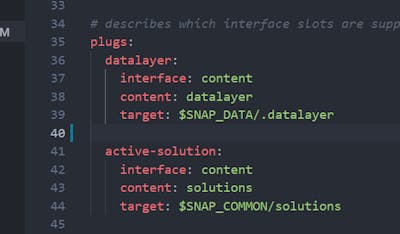

1. I added the plug as described:

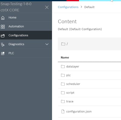

Via configurations (web interface) I see also no configuration for my helloplc snap. 😞

To simply store a file in the active configuration add the plug to your .yaml file:
plugs:
  active-solution:
    interface: content
    content: solutions
    target: $SNAP_COMMON/solutions
