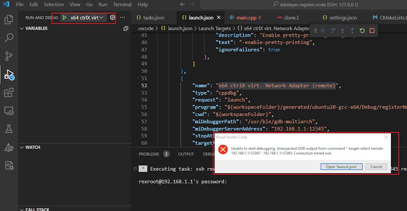

But,  in VS Code when I click Termial -->  Run Task… -->Launch Remote GDB Server, the terminal shows the message below: (password is required)
And when clicking run and debug button in the VS Code with option “x64 ctrlX virt. Network Adapter (remote)”, a error windows shows:

  1. ctrlX CORE virtual uses the network adapter:192.168.1.1
  2. ctrlX WORKS version 1.20.0, sdk package version 1.20.0
  3. Snap is built in debug mode
  4. Enable the C++ codes of “#ifdef MY_DEBUG” and SIGSTOP signal

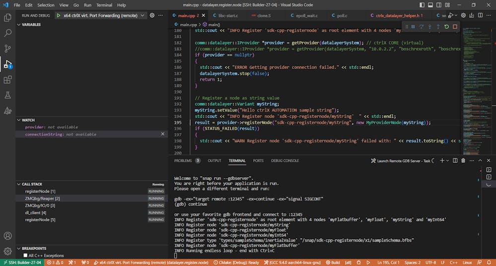

I just tried it out myself and I was able to get it run. I followed the Remote Debugging C++ document you mentioned.

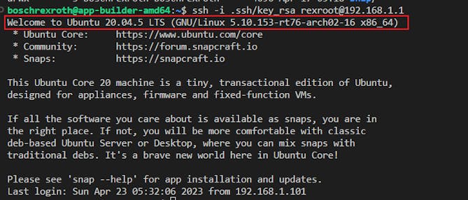

Maybe you should try to setup the ssh public key authentification first. I did it by performing the following steps:
  1. generating a id-rsa key pair in the App Build Environment (in folder home/boschrexroth/.ssh):
    ssh-keygen -t rsa

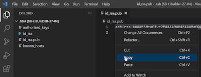

  2. copying the public key by hand
    copy the public key from the App Build Environment
  3. connecting to the ctrlX CORE and creating a folder ~/.ssh and in this folder the file authorized_keys
  4. paste the public key you copied out form the App Build Environment in there
Then I followed the documentation to set get this running. Note: you got start the debugging several times to get it running. The only changes I had to make were in the task.json (l.110): here I had to change the name of the snap to sdk-cpp-registernode (see screenshot).
