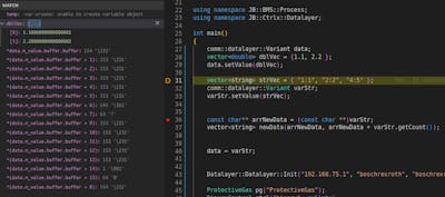

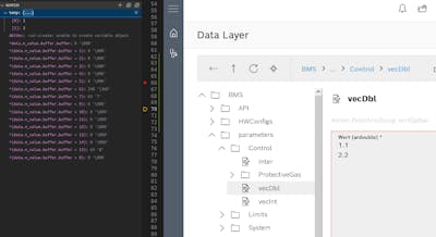

1. ardouble rounds down the values, which are entered in the datalayer, so that no decimal places arrive in the C++ program (arint works, as far as I could judge, without problems). He looked at the buffer data (data.m_value.buffer.buffer) in the Variant object and could already see there that the double value is only entered rounded into the buffer:
In the upper image, the double values read byte by byte result in 1 and 2, although the values 1.1 and 2.2 were entered in the datalayer.

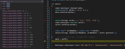

2. Arstring still adds quotes before and after the string. Also this behavior occurs only if the data comes from the datalayer:
Without datalayer:
With datalayer:

  1. Regarding the first bug you mentioned: This is a known bug of the data layer web browser. This will get fixed with the next release (V1.18)
  2. Regarding the second issue: This is also a known bug of the data layer web browser. It will get fixed with the next release (V1.18)
