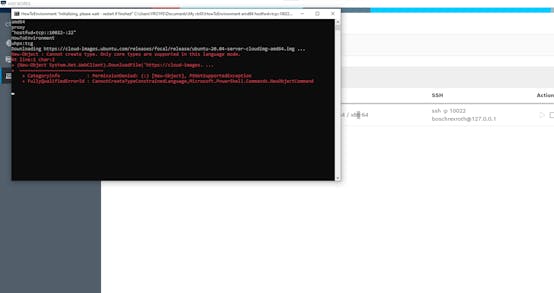

I've been encountering issues while starting my build environment, as it fails to boot properly. Despite following the instructions provided on this website , the system displays a notification indicating an error, as captured in the screenshot below. I've tried troubleshooting on my own, but I couldn't identify the root cause of the problem.
Has anyone else encountered a similar issue or can offer guidance on how to resolve this?

yes I would recommend to turn of your AppLocker, restart the PC and create a new App Build Environment.
btw.: In case your PC is managed by Bosch-IT you can deactivate the AppLocker in the "IT Workplace Toolkit".
