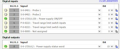

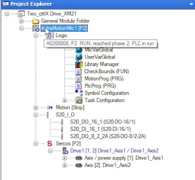

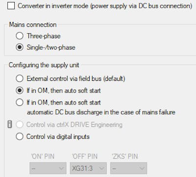

I have been testing a XMD with a XM21 on sercos. looked like there is communication issue between XM21 and XMD on sercos. Indraworks used was V15 and CtrlX drive engineering was V118.1. no matter I powered up the drive first or XM first. the XM always stayed at P2. the power control of the drive was setup as below and wired BB to XG31.3 and use XG31.8 to turn on the power for second axis.
the only way to turn on drive to AB was to manually switch the sercos to BB without a program. there was no error showed.
is that normal or did I miss any setting caused this issue?
