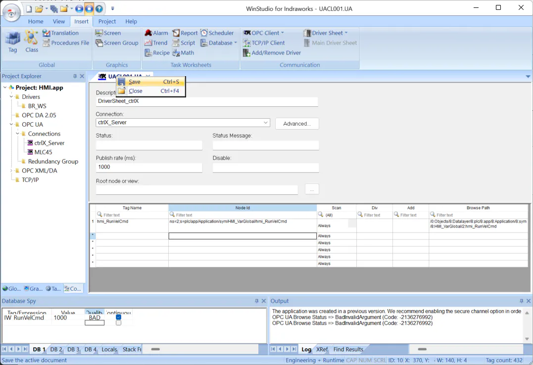

I am working with WinStudio from IndraWorks, version 15V22. I have an OPC-UA connection that is working. I insert a driver sheet using that connection. I can find the symbol file and load the variable from there and assign it to a tag. When I try to save the driver sheet, it opens the driver sheet number dialog, as if it is saving it. When I go through with this, it never shows up on the left side of the screen. Seems like it never gets saved.
Any idea what is happening?

Just figured this out. I closed WinStudio, then reopened, and all of the driver sheets that I created appeared. WinStudio is now functional.
