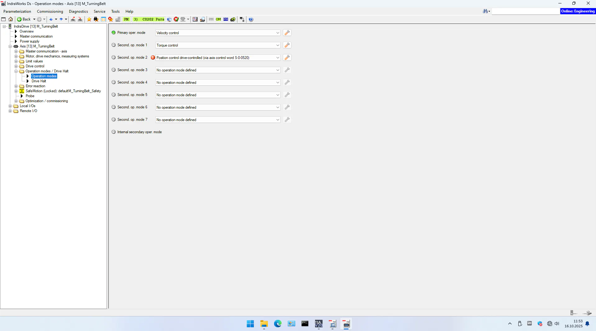

As part of an application development, I’m controlling an asynchronous motor without an encoder using an HCS02 drive, reference: R911305034 (R911298374 + R911338543 + R911347141). The motor is operating correctly; I have no issues controlling it.
My problem arises during machine startup. When I power off and restart the machine, the drive automatically sets Second Op Mode 2 to Position control drive controlled. Since there is no encoder feedback, this setting is not suitable, and the drive switches to PM mode.
When I manually force this parameter to 0, the drive exits PM mode, and I’m able to start the machine. However, this setting reappears at every startup, which leads me to believe that the PLC is writing this parameter again.

I think you need to configure the IndraDrive as "Open Loop" axis in IndraWorks.
Just choose the correct axis under "Motion", right click and select "Properties".
Here you can disable "Closed loop". Now download the Motion configuration again and your problem should be solved.
