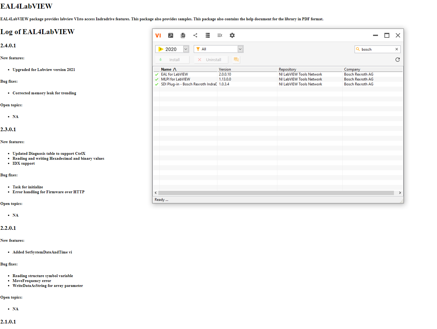

I have also noticed that only EAL version 2.0.0.10 is supported for LabVIEW 2020 (32bit) in the LabVIEW Package Manager. Only when using LabVIEW 2021 (64bit) and a ctrlx drive can I use the latest version 2.4.0.1 version. The Labview Package Manager does not offer the latest version, nor can it be installed manually.
Are the new EAL versions not backward compatible? Since there were some bugfixes between the two versions, I would of course like to use the latest version of the EAL with LabVIEW 2020 (32bit).
