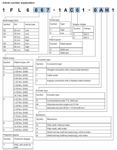

Original Siemens drive is not available with me, So I am thinking to use Rexroth Indradrive. Application is velocity control over profinet protocol.
Siemens Servo Motor model - 1FL6092-1AC61-2LB1
