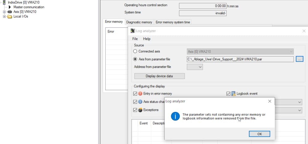

To get details for the Jitter on Beckhoff side, please address to Beckhoff!
The drive parameter file unfortunately shows no valid entries:

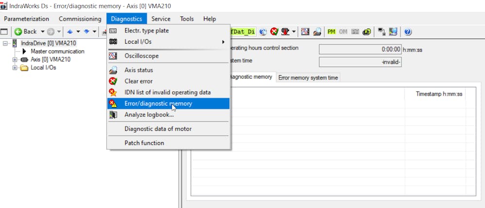

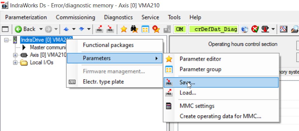

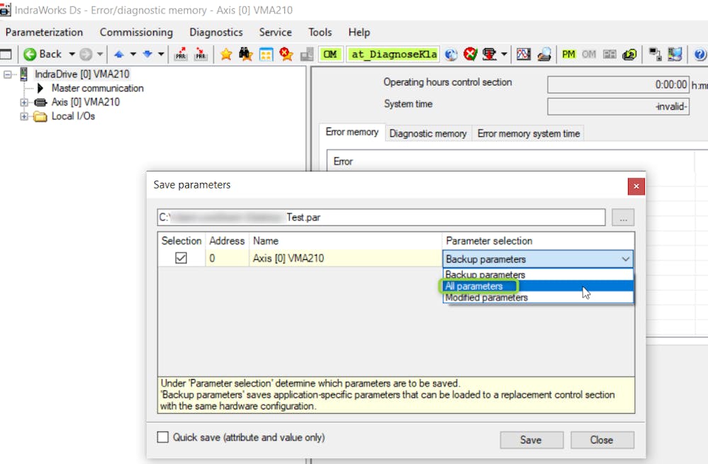

Presumably you didn´t save the parameters, as told, using format "all parameter". Either send this or a screen shot of the diagnsotics logbook!
